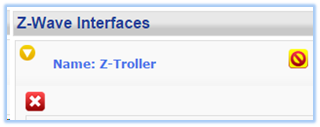

  3. Navigate to Controller Management and disable the interface by clicking the green check mark to the right of the interface name. A yellow and red crossed out circle will appear, once the interface is disabled.
  4. Delete the interface from the software by clicking the delete button underneath the interface name. You must do this to avoid "Home ID" conflicts with SmartStick+. DO NOT SKIP THIS STEP and DO NOT ERASE YOUR EXISTING INTERFACE!
