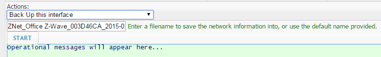

  2. Expand the listing for your interface, then select Back Up this interface from the Actions menu.
  3. Rename the backup file (if desired) and click the START button (as shown below). The operation should only take a few seconds and the word "Done" will appear when complete. Note the name of this file for later.
