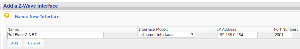

    1. If your Z-NET has a DHCP-assigned IP address, enter a name for your Z-NET and select Z-NET Ethernet from the Interface Model menu. Then choose your interface from the drop menu. If you're using the WiFi adapter, you'll see 2 entries. Likewise, if you have multiple Z-NETS installed, you'll see an entry for each.
    2. If your Z-NET has a persistent (static) IP address, enter a name for your Z-NET and select Ethernet Interface from the Interface Model menu. Then enter the IP address of your Z-NET and port 2001.
  4. Finally, click the yellow and red disable button to enable your new Z-NET. A green enabled button should now appear.
