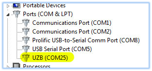

- Physical Installation: Simply attach SmartStick+ to your system using the USB connection. If the driver is installed, a COM port number will be assigned by the operating system. To confirm this, open your Windows Device Manager and expand the "Ports" section. Your SmartStick+ will appear as a "UZB" device. In the example below, Windows has assigned COM port #25 to this SmartStick+.
