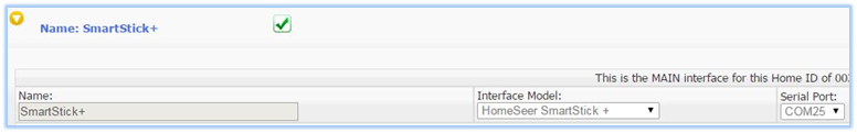

  2. Open the PLUG-INS drop menu, then Z-Wave, then click Controller Management. Click the Add Interface button.
  3. Name your SmartStick+, select the SmartStick+ as the device type and then correct COM port.
  4. Finally, click the yellow and red disabled button to enable your new SmartStick+. A green enabled button should now appear.
