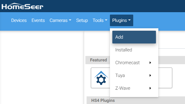

Installation
  1. Navigate to Plugins > Add to get to the HS4 plugins list. Here, you will see a list of featured plugins and you may also search for a desired plugin.
  2. Once you have found the plugin you are looking for, click on it. A small window will pop up in your browser, giving you the options to view the store page, support forum or release notes for that plugin. Below these options, there is an Install button, click that.
  3. You will see another small pop-up indicating that the plugin installation has either succeeded or failed. If it succeeded, you will be brought to the Installed page, where you can enable and start setting up your plugin. If the install failed then make a note of the exact message you receive and reach out to us and we will be happy to assist!
